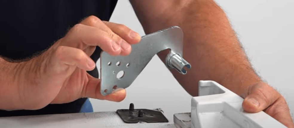

Removing the Old Hinge
After gathering the necessary tools and taking safety precautions, you’re ready to start the removal process. Here’s a step-by-step guide on how to remove the old hinge:
- Locate the Hinge: Climb to the top of the fridge and locate the right side hinge. This is the one you’ll be replacing.
- Remove the Hinge Cover: There should be a cover that hides the hinge. Use your 1/4″ nutdriver to remove the screws holding this cover in place.
- Support the Door: While you work on the hinge, use your other hand to support the refrigerator door. This prevents the door from falling or swinging uncontrollably when the hinge is removed.
- Remove the Screws: Using your 5/16″ nutdriver, remove the three screws that hold the hinge in place. Be sure to keep these screws in a safe place, as you’ll need them to install the new hinge.
- Lift Out the Old Hinge: Once the screws are removed, you should be able to lift the old hinge out of its position.
Throughout the process, remember to work slowly and carefully to avoid damaging any other parts of the refrigerator. If the hinge is stubborn or rusted in place, don’t force it. Apply a bit of penetrating oil and let it sit for a few minutes before trying again.
Installing the New Hinge
Once you’ve successfully removed the old hinge, it’s time to install the new one. This process might seem a bit daunting, but by following these steps, you can ensure a successful installation:
- Position the New Hinge: Place the new hinge in the same position where the old hinge was located. Make sure it’s oriented in the same direction as the old hinge.
- Secure the Hinge: Using your 5/16″ nutdriver, start securing the hinge with the screws you removed earlier. Don’t fully tighten the screws until all are in place.
- Tighten the Screws: Once all screws are in and the hinge is properly aligned, tighten the screws fully. Ensure the hinge is secure but be careful not to over-tighten as it could strip the screw holes.
- Check the Door Alignment: After the hinge is securely fastened, check the door’s alignment. It should open and close smoothly without any resistance. If the door seems off, you may need to loosen the screws slightly and adjust the hinge’s position.
Remember, patience is key during this process. Take your time to ensure the hinge is installed correctly and that the door’s alignment is perfect. This attention to detail will help extend the life of your fridge and ensure optimal performance.
