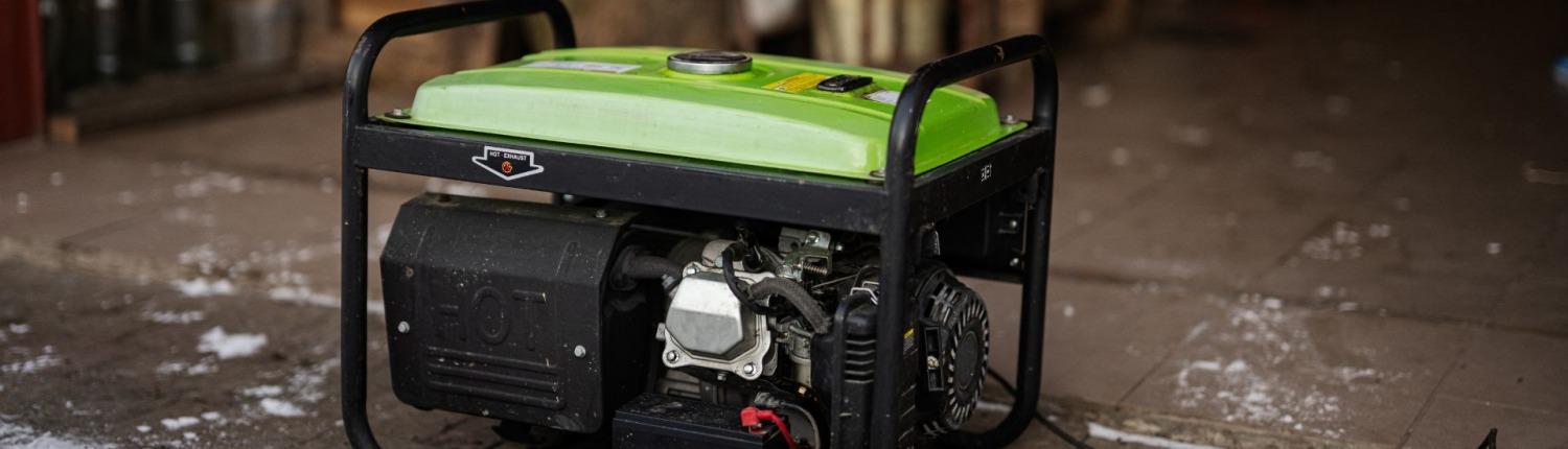

generator resting on garage floor near ice from storm
