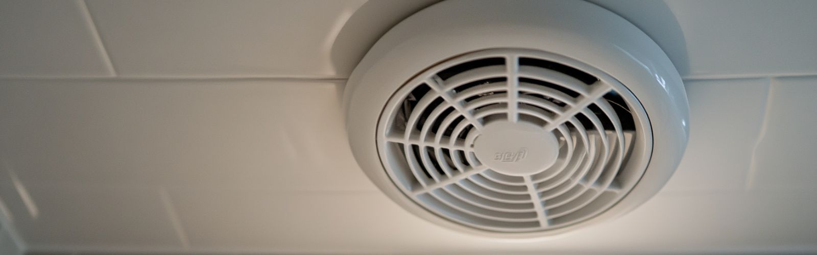

Your bathroom fan is a big help in keeping things fresh, until it starts spinning slower than usual. That drop in speed leads to extra humidity and unpleasant smells that stick around more than you’d like. The good news is, a little bit of DIY investigating and a thorough cleaning or parts swap can get it back up to speed.

Step one: Inspect and clean the fan grille
One of the biggest culprits behind a sluggish fan is a dusty or clogged grille. Debris around the grille limits airflow and makes the motor work much harder.
- Check for clips or screws that hold the grille in place.
- Take off the grille and set it down somewhere safe.
- Use a vacuum or gentle brush to clear dirt and lint from the grille.
- If there’s stubborn gunk, wipe it off with a damp cloth.
- Look for cracks or damage that might reduce airflow.
- Once it’s clean, snap it back on.
