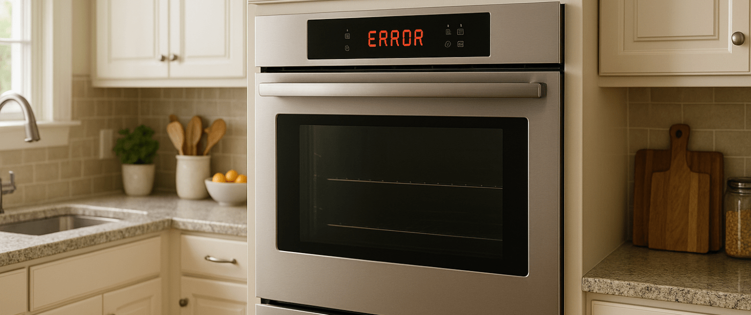

If your Bosch oven is flashing an F112 or F114 error, don’t worry, you’re not dealing with anything overly complex. We’ll break down what each code means, what typically causes them, and how you can fix the issue yourself without needing to call in a repair tech.

What is an F112 error code?
The F112 error code indicates that the lower oven cavity in a Bosch double wall oven has surpassed its safe operating temperature limit and gone into thermal runaway.
Each oven cavity contains a temperature sensor connected back to the main control board. If the lower oven sensor reports a temperature reading above 950°F, the F112 fault will be triggered and the oven turned off.
