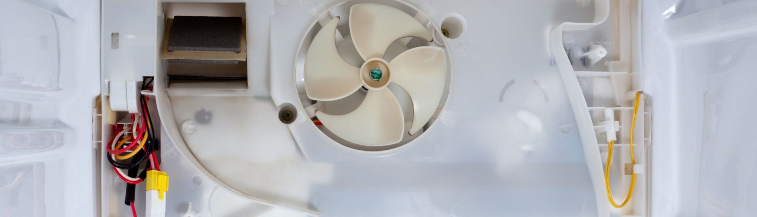

Evaporator fan issues
In the freezer compartment, a buzzing or grinding noise might be coming from the evaporator fan. Just like the condenser fan, ice or food particles can obstruct the blades of the evaporator fan and cause strange sounds.
Try defrosting and cleaning the fan blades to resolve this problem. It’s also a good idea to inspect the fan’s mounting and wiring for any damage. Be sure to replace deteriorated rubber grommets or frayed electrical connections as soon as possible. If the fan blade still doesn’t turn smoothly or the motor keeps emitting a buzz, it’s likely time for a new evaporator fan unit.
