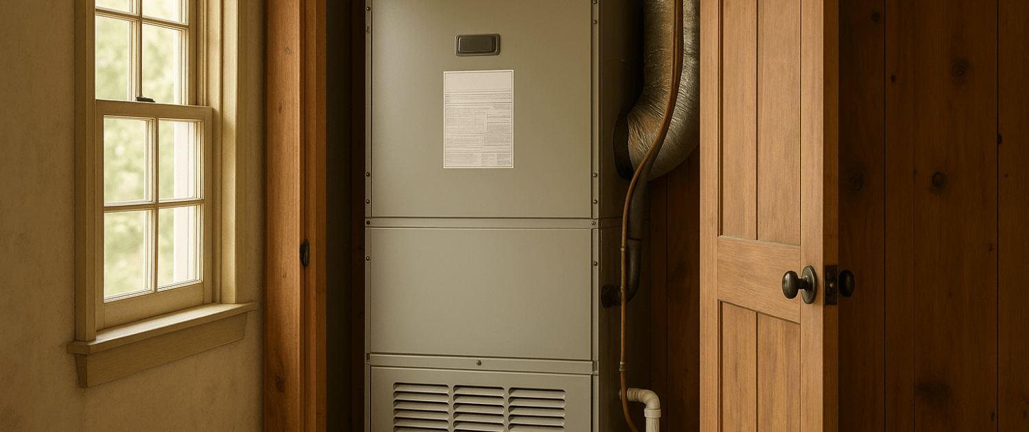

Step 3: Check the Emergency Shutoff Switch
Most central AC systems have a manual disconnect switch located:
- Near the indoor air handler/furnace, or
- Near the outdoor condenser unit
This switch looks like a light switch or pull box and is used by techs for safety during service. Sometimes it gets flipped off accidentally during cleaning or storage.
What to do:
- Locate the switch near your indoor unit (often mounted on a nearby wall or ceiling).
- Make sure it’s switched ON.
Still nothing? Move to the outdoor disconnect box:
- Open the cover on the outdoor box near the condenser.
- Check for a pull-out fuse block or switch.
- Make sure it’s securely inserted and in the ON position.
