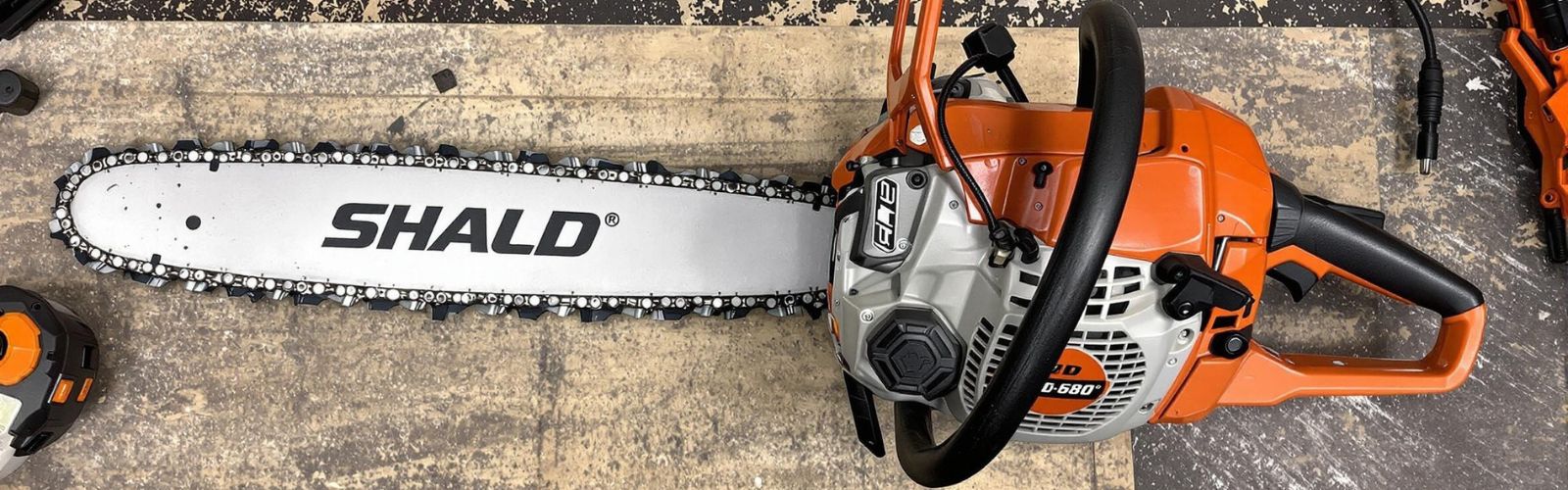

Remove the air filter
Getting the air filter out is usually pretty straightforward, but always follow your chainsaw’s specific instructions. Generally, here’s how you do it:
- Shut down the chainsaw: Make sure it’s off, and unplug the spark plug wire to prevent any accidental starts.
- Find the air filter cover: It’s typically near the top or side of the engine. Look for a plastic cover held by screws, a latch, or a knob.
- Take off the cover: Use the right tool—a screwdriver or your hands—to loosen screws or undo latches. Some covers just pop off.
- Remove the air filter: With the cover off, you’ll see the filter, usually made of foam, felt, or mesh. Carefully lift it out, noting how it sits.
Clean the air filter
Now that you’ve got the filter out, take a good look at it. If it’s just a bit dirty, a clean might be all it needs. Here’s how to spruce it up:
- Check for damage: Look for any tears, holes, or warped edges. If it’s torn, you’ll need a new one to keep the engine safe.
- Brush off debris: Gently use a soft brush or cloth to knock off dust and sawdust. You can tap it lightly against something if it’s a foam or mesh type.
- Blast it with air (optional): If you’ve got compressed air, give the filter short bursts to clear out fine particles. Keep the nozzle a few inches away.
- Wash it (if allowed): Some filters can be washed in mild soapy water. Check your manual to be sure. If you do wash it, let it dry completely before it goes back in.
Put it all back together
With the filter sorted, it’s time to reassemble your chainsaw. Here’s the rundown:
- Peek at the spark plug: While you’re at it, check the spark plug for any heavy buildup or damage. Cleaning or replacing it can complement your filter work.
- Reattach any parts: If you removed other covers or parts, put them back according to your chainsaw’s instructions.
- Reconnect the spark plug wire: Don’t forget to plug it back in so your chainsaw will start.
- Check the chain tension: A loose or tight chain can affect performance and safety. Adjust it as needed.
