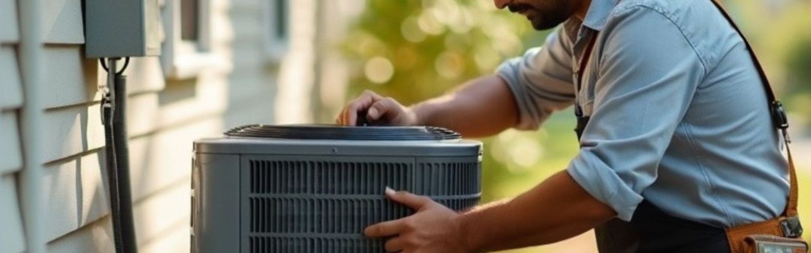

How to clean the condenser coil
Your condenser coil is located in the outdoor part of your AC system. It’s usually inside a metal housing with slatted sides that let air flow through. Since the condenser coil sits outside, it’s more likely to collect leaves, dirt, grass clippings, and other debris.
Before you get started, always make sure to turn off the power to the unit at the breaker and the external disconnect box. Outside, you’ll typically find a small box or switch near the AC unit. This step keeps you safe from electrical shocks.
Step 1: Clear the area around the condenser
- Get rid of any big debris, sticks, or leaves that are blocking the fins. Trim back any overgrown plants near the condenser so there’s at least two feet of space around the unit. This helps with proper airflow.
- Use a garden hose to rinse the exterior fins from top to bottom. Spray at an angle to avoid bending the fins. Work carefully so you don’t push more dirt inside.
Step 2: Deep-clean the condenser coil
- Spray an approved outdoor coil cleaner onto the fins. Follow the label instructions on how long to let it foam up.
- Rinse thoroughly with a gentle stream from your garden hose, moving in downward strokes and working in small sections. This washes away dirt and any leftover cleaner.
- Take a moment to check if any fins are bent. If they are, gently straighten them with a fin comb or carefully with your fingers. Bent fins can limit airflow and make your AC work harder.
Step 3: Final check of the outdoor unit
After rinsing, give the condenser coil a good look to spot any remaining debris, especially in tight corners. If you see stubborn clogs, go ahead and repeat the cleaning steps. Make sure the coil dries off before you turn the power back on. While you’re waiting, check the overall exterior of the unit for any damaged or rusted panels.
