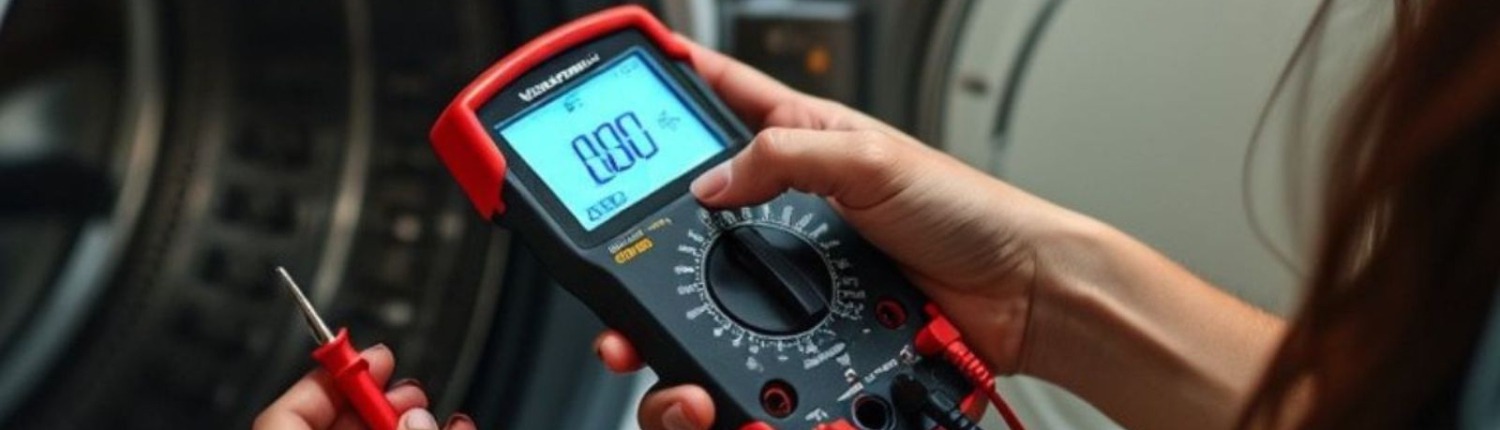

How to test for continuity with a multimeter
Testing for continuity is one of the easiest things you can do with a multimeter. If you’re checking a part and you suspect it’s broken, continuity testing will give you a quick answer.
Here’s how to test for continuity:
- Turn your multimeter’s dial to the continuity setting (usually represented by a sound wave or sideways WiFi symbol). You can also set the meter to the lowest resistance setting if your multimeter doesn’t have a dedicated continuity option.
- Plug the black meter probe into the “COM” (common) port and the red probe into the port labeled with the ohm symbol (Ω).
- Touch the two probes together. If your multimeter is set to continuity, it should beep. If you’re testing resistance, you’ll see a reading (typically close to 0 ohms).
- Place one probe on each end of the part you’re testing. For instance, if you’re testing a wire, touch one probe to each end of the wire. If your multimeter beeps, you have continuity – meaning the wire or part is good. If it doesn’t beep (or shows infinite resistance), that means there’s a break in the circuit and the part needs to be replaced.

How to test for resistance with a multimeter
Testing for resistance is especially helpful when checking parts such as heating elements, thermostats, or any other part that should have a certain resistance level.
Here’s how you can easily test for resistance:
- Turn your multimeter dial to the resistance setting, which is indicated by the symbol Ω.
- Plug the black probe into the “COM” port and the red probe into the port marked with the ohm symbol (Ω).
- Make sure the appliance is disconnected from the power source so that you’re only measuring the part’s resistance.
- Place the meter probes on either end of the part you’re testing. For example, when testing a heating element, touch one probe to each terminal of the element.
- Check the results. A low resistance reading (close to zero) typically means the part is good. A high resistance or an infinite reading (the multimeter will usually display “OL” or “∞”) usually means there’s a break in the circuit and the part is faulty.
