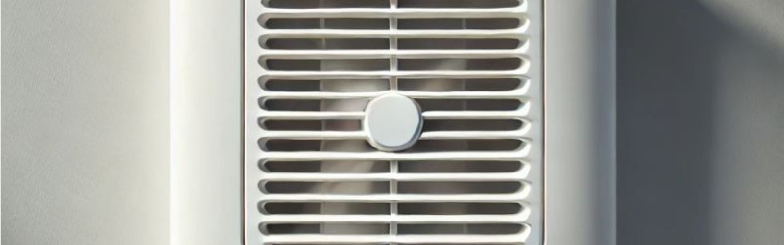

If you’ve ever turned on your bathroom light and heard an unusual rattling sound, or noticed a cracked, unsightly vent cover detracting from your bathroom’s appearance, it may be time to replace the fan vent cover. Fortunately, this is a straightforward DIY project that can improve both the functionality and aesthetic of your space. You won’t need any specialized tools, just a few basic ones and careful handling of the fan housing. We’ll guide you through the process step by step, so you can achieve a cleaner, quieter ventilation system with ease.

With the power off, gently pull down the old cover. The method will depend on how the cover is secured:
- Spring-clamp covers: These covers are typically held in place by two metal arms. Pull the cover down, then pinch the springs to release one side. Repeat on the other side.
- Clip-in covers: If you see plastic or metal clips, gently press or unhook them using your fingers or a flat-head screwdriver. Be careful not to break any plastic if you plan to reuse the clips.
- Screw-in covers: Use a Phillips or flat-head screwdriver to remove any screws securing the cover. Keep the screws, you may need them for the new cover.
Make a mental note of where the clips, springs, or screws are located to ensure the new cover fits correctly.

4. Install the new vent cover
With the fan housing cleaned and prepped, it’s time to install the new cover. Here’s how to do it:
- Position the cover: Line up any notches, springs, or screw holes with the openings in the fan housing. Press the cover upwards gently to make sure it’s seated properly.
- Attach springs or clips: If your cover uses spring arms, pinch them and slot them into place. The springs will expand to hold the cover securely. For clip-in covers, simply snap them into place.
- Screw-in covers: Align the screw holes on the new cover with those on the housing. Reuse the screws you removed (or use the new ones that came with the cover). Tighten gently, don’t overtighten, as too much force can crack the plastic.
Give the cover a light tug to ensure it’s securely attached. If it feels loose, remove it and adjust until it’s snug. A secure fit helps minimize noise and improves fan performance.
