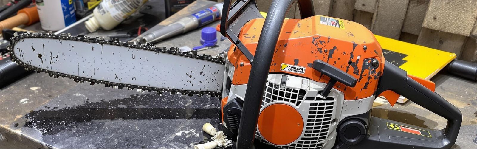

Steps to fix a leaking chainsaw
When you spot oil leaks, it’s tempting to ignore them, but that’s a bad idea. Leaking oil wastes lubricant, makes a slippery mess, and can mess with your saw’s performance. The good news? You can usually fix these problems at home. Here’s how to tackle them step by step.
Clean the chainsaw thoroughly
- Wipe down the entire saw with a rag to remove any built-up oil and sawdust.
- Use compressed air or a soft brush to clear around the oil cap, bar, and chain area.
- This helps you spot where the oil is actually coming from, not just where it ended up.
Check the oil tank cap
- Inspect the oil cap for cracks, worn threads, or a damaged rubber gasket.
- Tighten it firmly and see if that helps reduce the leak.
- Replace the cap or gasket if it looks worn or doesn’t seal tightly.
Inspect the oil tank vent
- Locate the oil tank vent (usually a small rubber valve).
- If it’s clogged, it can create pressure that forces oil out.
- Clean it gently or replace it if it looks damaged or blocked.
Examine the oil line
- Remove the side cover and, if needed, the bar and chain.
- Look for the oil line inside the saw, it runs from the oil tank to the bar oiler.
- Check for cracks, kinks, or loose connections.
- Replace the oil line if it’s damaged or brittle (most are inexpensive and easy to swap).
Check the bar oiler and outlet hole
- Clean the oil delivery hole in the bar, it can get clogged with sawdust and gum up the flow.
- Use a small pick or wire to clear any blockages.
Inspect the oil pump (optional for advanced DIYers)
- If oil is pouring out while the saw sits still and the above steps don’t help, the oil pump might be worn or stuck open.
- This may require disassembling more of the saw or checking for stripped gears or failed seals.
- Replace the oil pump if necessary (be sure to get the exact match for your chainsaw model).
Store the chainsaw properly
- Even after fixing a leak, storing your saw properly makes a big difference.
- Keep it upright with the bar pointing down or resting on a catch tray or absorbent mat to contain any residual drip.
Test it after reassembly
- Fill the oil tank about halfway.
- Run the saw for a minute or two, then shut it off and check for new leaks.
- Let it sit overnight on a clean surface to confirm everything’s sealed up.
Pro Tip: If you don’t plan to use the chainsaw for a while, drain the bar oil before storing it, this can prevent long-term seepage and reduce mess.
