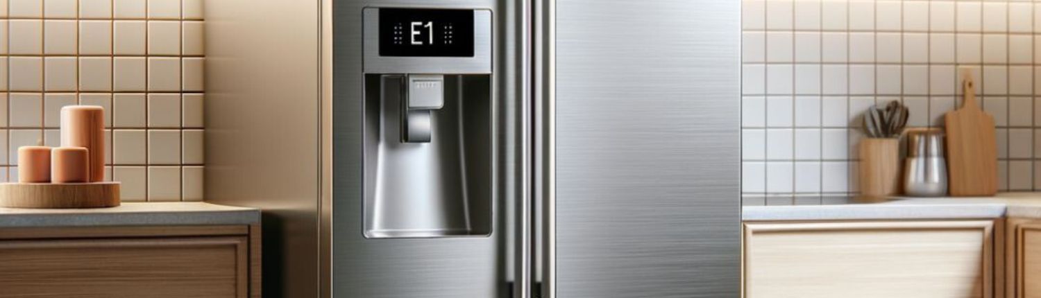

E1 Bosch refrigerator error: A troubleshooting guide from the pros
Steven E / Thursday July 25, 2024
If you’re seeing an E1 error on your Bosch refrigerator’s display, don’t worry! You can troubleshoot this error yourself without the need for an expensive service call or technician.
Let’s get your fridge back up and running.
If you find out that you need any replacement parts for your Bosch refrigerator while you’re troubleshooting, you can enter your model number at AppliancePartsPros.com to order them. Most orders arrive in just two business days, and we have thousands of free guides to show you how to install your new parts.
What does an E1 error code mean?
An E1 error code typically means there’s a problem with the refrigerator’s temperature sensor.
The sensor provides constant temperature feedback to the main control board. If the readings go outside expected values, the control board will throw an E1 error code to let you know something is wrong.
The most common cause of the E1 error is a faulty sensor, but it could also mean there’s a problem with the wiring, connections, or the control board itself.
