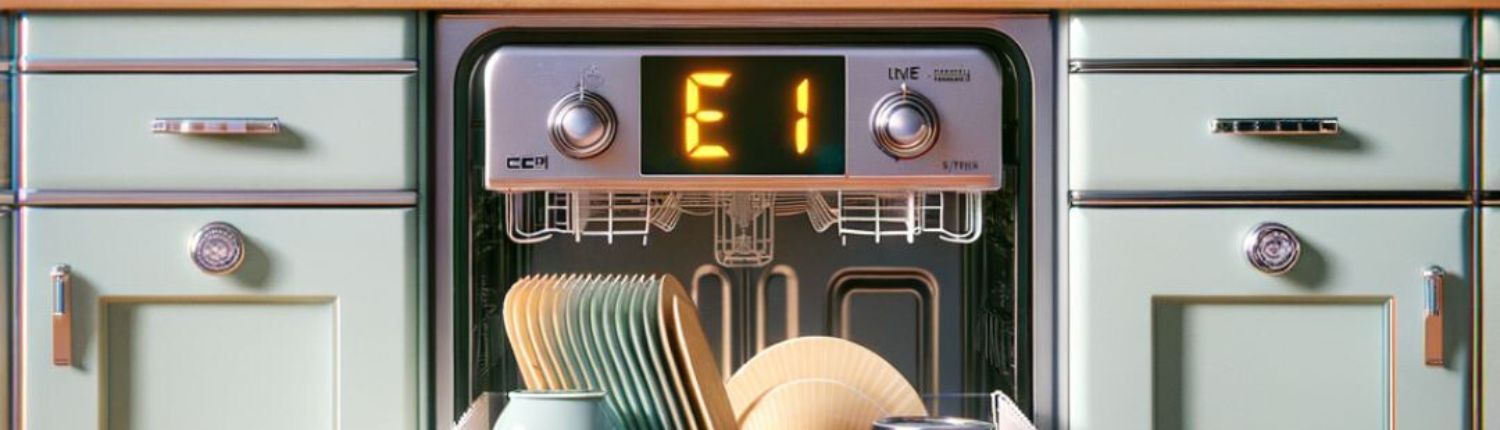

E1 error on a Bosch dishwasher: A complete troubleshooting guide
Steven E / Thursday July 25, 2024
Are you seeing an E1 error code on your Bosch dishwasher? As frustrating as this can be, you’ll be happy to know that you can troubleshoot and fix this problem yourself — without the need for an expensive service call or technician.
If you need any replacement parts for your Bosch dishwasher, you can use your model number to find what you need at AppliancePartsPros.com. We also have thousands of free DIY troubleshooting and repair guides to help you fix your appliance yourself.
Full safety notes below
What does the E1 error code mean?
The E1 error code typically means the dishwasher’s control module has detected a problem with the heating circuit.
This could be caused by a faulty heating element, NTC sensor, high-limit thermostat, circulation pump, control module or wiring.
