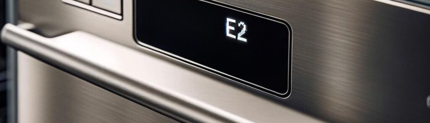

If your Bosch dishwasher is displaying an E2 error code, it usually indicates a problem with the NTC (temperature) sensor. You’ll most likely need to fix the faulty NTC sensor or related wiring.

The E2 code specifically indicates that the control module has detected an issue with the NTC (“negative temperature coefficient”) sensor’s output. The NTC sensor monitors the temperature of the water during the dishwasher’s wash and rinse cycles. Depending on the model, it’s on or near the heating element and detects resistance changes as the water heats up. The resistance decreases as the temperature rises.
If the control module isn’t receiving the expected resistance values from the sensor, it will trigger the E2 error. This could mean:
- The NTC sensor has failed
- There’s a wiring problem between the NTC and the control module
- The control module’s input circuitry has malfunctioned
