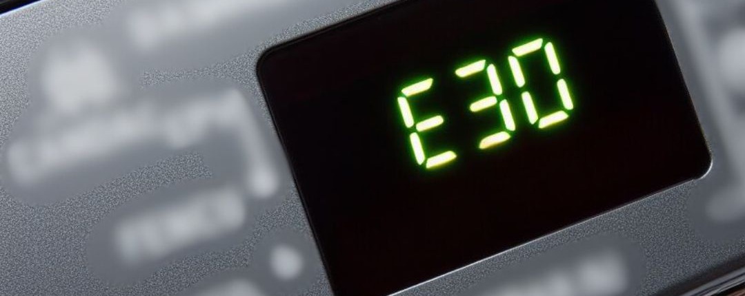

One common error message that might show up on your GE washing machine is the E30 drain code, which means there’s probably an issue with the drain pump or drain system.
Depending on what you find out during the troubleshooting process, you may need to replace the drain pump assembly. You can find a replacement by entering your model number in the search bar at AppliancePartsPros.com.
Let’s cover the steps for diagnosing and resolving the E30 error on your GE washer so it can drain correctly again.
Disclaimer: The troubleshooting information provided in this article is based on general service manuals and may not apply to your specific appliance model. While we strive to offer helpful advice for DIY appliance repairs, variations in models and configurations can lead to differences in troubleshooting steps, error codes and part replacements. For the most accurate guidance, we strongly recommend consulting the technical sheet for your specific appliance model.
What does the E30 code mean?
An E30 error code signifies a “drain pump not present” condition on GE front load washers. It means that you either have a water level pressure sensor that’s not communicating with the electronic control board, that you have a water overfill condition, or that it doesn’t register that the level is dropping during the drain part of the cycle.
When an E30 code shows up, the washer won’t progress through the cycles and drain water as it normally would. You need to find the source of the issue and repair it to make the error code disappear.
