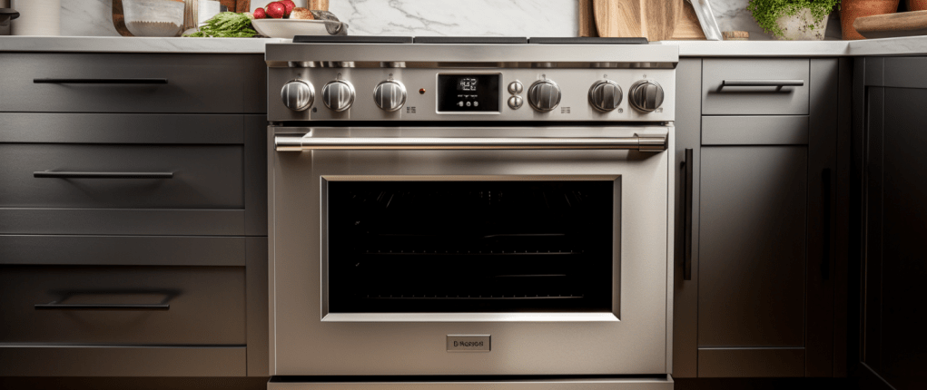

Symmetrical shot of a range in a kitchen showingE9 Thermador Range Error Code
The appearance of an E9 error code on some Thermador oven models signifies a problem with the internal cooling fans not operating properly during heating cycles. These fans are critical to preventing overheating of temperature-sensitive electronic components and wiring. Without adequate airflow, the oven can quickly reach unsafe temperatures resulting in an E9 Thermador Range error code.
