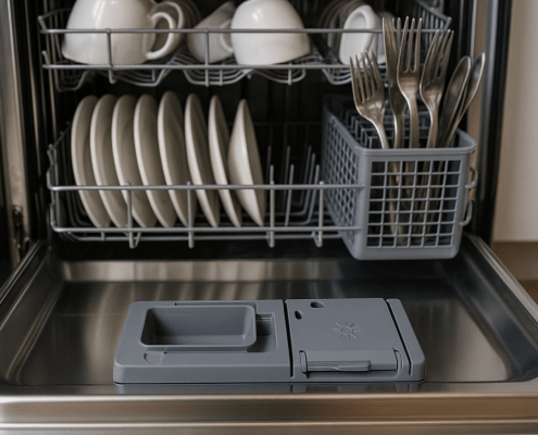

Step 2: Remove the Dishes
If you haven’t already, take out all the dishes and utensil baskets. Set them aside on a clean surface or in the sink so you have full access to the bottom of the dishwasher.
Now you can clearly see the extent of the standing water problem, and start dealing with it head-on.
