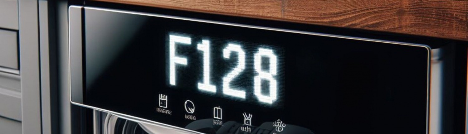

What causes an F128 error?
GE dishwasher fault code F128 is usually triggered when the rinse aid level runs low. Rinse aid is an important part of the wash cycle that reduces beading and streaking on dishes and glassware. The rinse aid is held in a storage tank inside the detergent dispenser.
The rinse aid tank can hold about 100 mL or 3.5 oz of liquid. As rinse aid is used during each cycle, the level eventually drops low enough to trigger the F128 sensor fault. On dishwashers with an LCD, the code will show on the screen. Models with indicator lights will blink the “Rinse Aid” LED light.
In either case, F128 means it’s time to refill the rinse aid reservoir. But if the code persists after topping off the tank, you’ll have to continue troubleshooting.
