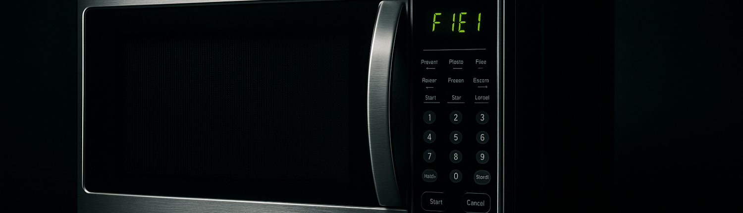

On Whirlpool microwaves, the F1E1 error code explicitly indicates a problem with the relay control board. This is the main control board that houses the relays which control the various microwave components such as the magnetron, turntable motor, lights, etc.
The relay control receives inputs from the touchpad and sensors, then signals the relays to power on the different components to start the cooking process. If the board is defective, it can cause an F1E1 display on the control panel. The error may show up suddenly, preventing the microwave from starting. Or it may happen intermittently, allowing the oven to work sometimes but not always. In either case, the relay control unit will need to be replaced to permanently clear the F1E1 error.
