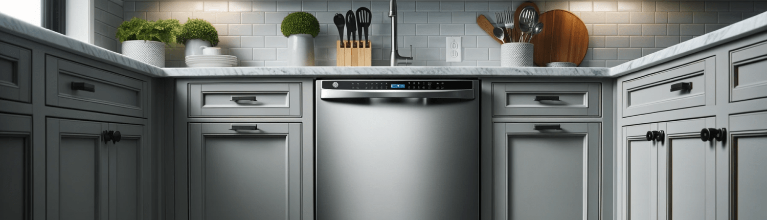

Direct front view photo of a kitchen highlighting a GE dishwasher F52 error code with its door shut, surrounded by sleek gray cabinetry
