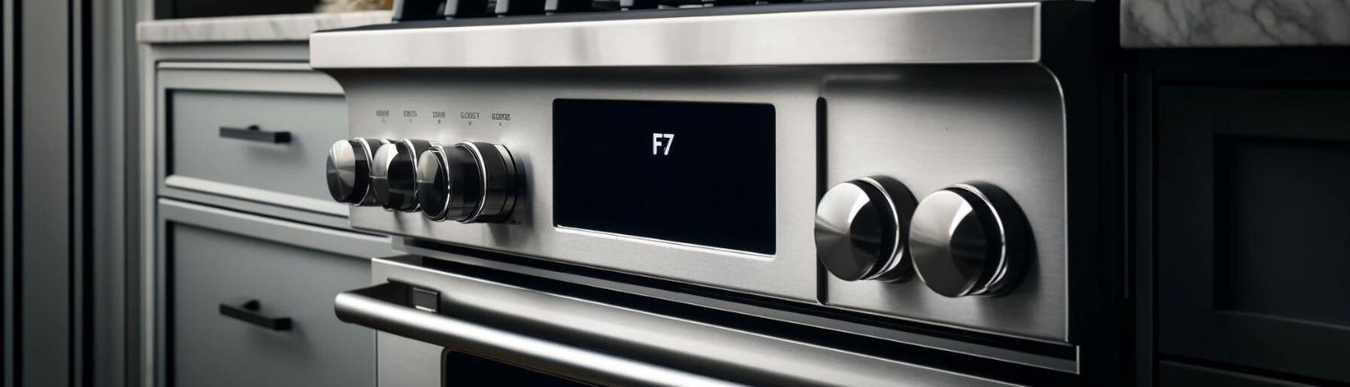

F7 error on an electric Frigidaire range: A troubleshooting guide
Samantha Bullington / Tuesday May 28, 2024
If you’re seeing the F7 error code on your electric Frigidaire range, don’t get down in the dumps. You can troubleshoot this error yourself with a few tools, a bit of time and the steps in this guide.
Let’s dig in so you can find the problem and get your range back in working order.
