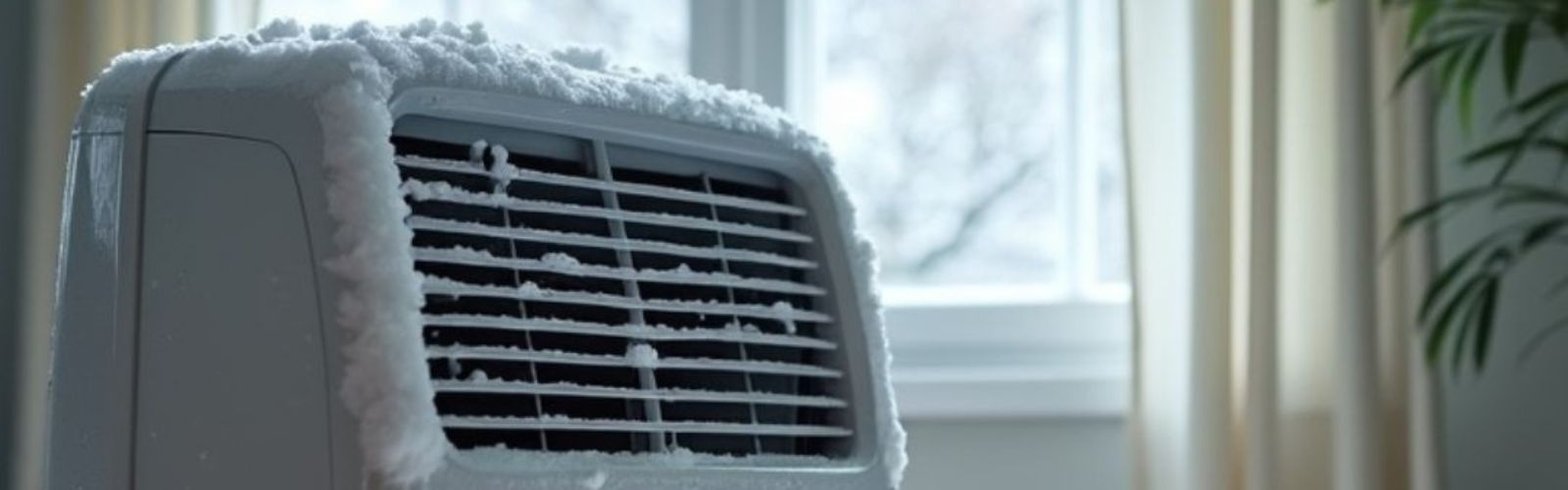

Checking for dirty coils
The evaporator coils need to be clean and free of ice to extract moisture properly. Dust buildup or icing can hurt performance. To check the coils:
- Again, unplug the unit before starting to avoid any shocks.
- Access the internal parts by removing the outer housing (check your manual for the right way to do this).
- Look for dirt or frost on the evaporator coils. If you see ice, let it melt on its own. Wipe up any water with a soft cloth.
- If they’re dirty, gently clean the coils using a soft brush or compressed air. Be careful not to bend the fins.

Checking room temperature and ventilation
Many dehumidifiers don’t work efficiently in temperatures below 65°F. If you’re using a regular home dehumidifier in a chilly basement or garage, the coils might freeze up. Some models have “low-temperature operation,” but you still want the environment to be above 41°F for safe use. Also, think about how often you open doors or windows, fresh outside air can bring in extra moisture. In these cases, your dehumidifier has to work harder and might not easily reach the target humidity.
