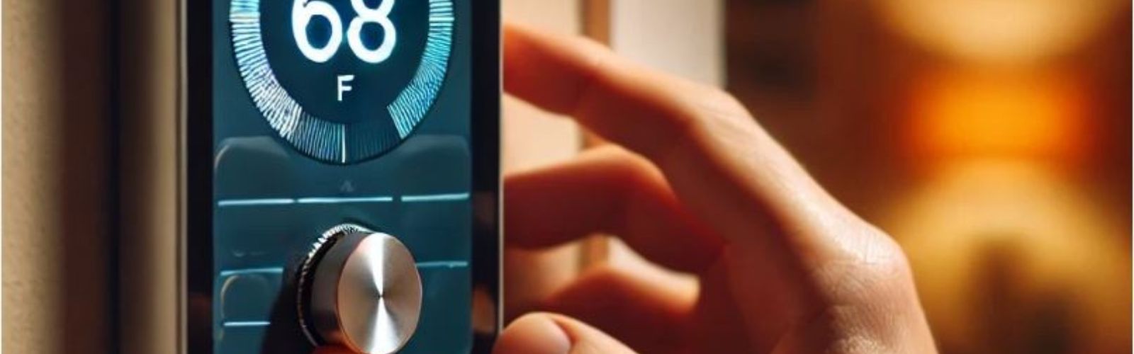

Check the thermostat settings
The thermostat is often the first place to check when your furnace isn’t heating. If the thermostat isn’t set correctly, it can prevent the furnace from kicking on.
  1. Make sure the thermostat is set to “heat” mode.
  2. Adjust the temperature setting to be higher than the current room temperature.
  3. If your thermostat uses batteries, replace them with fresh ones.
  4. Reset the thermostat to see if it resolves any glitches.
Once the thermostat is correctly set and functioning, you can rule out this simple cause and move on to more complex checks.
