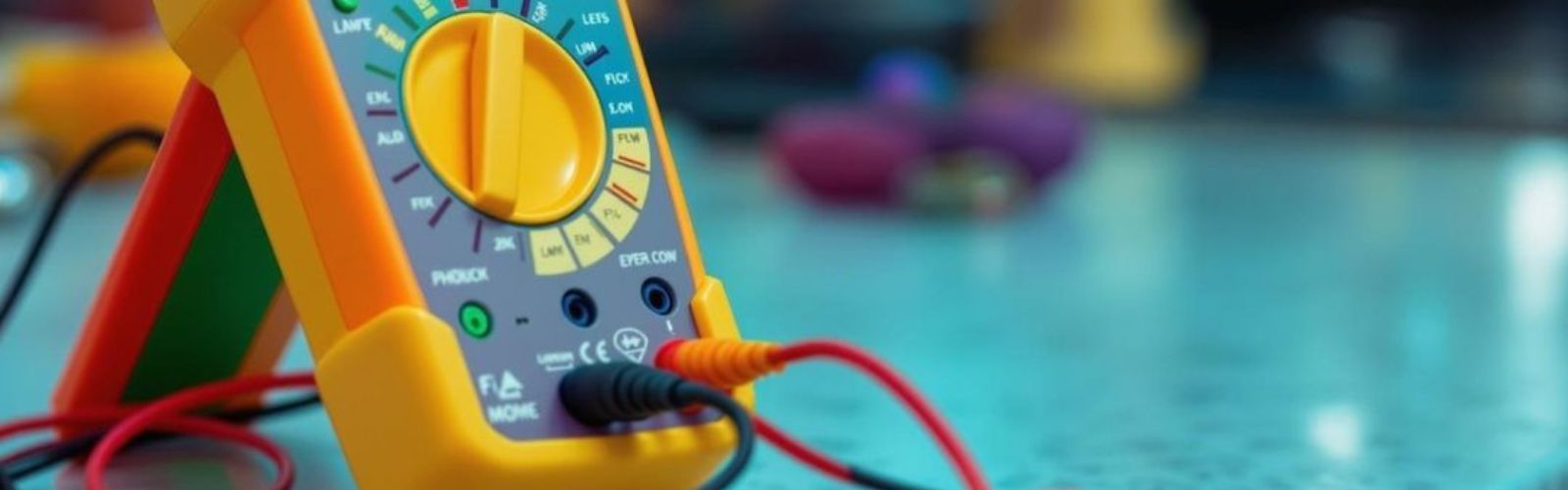

- Never assume a capacitor is discharged. Always check with a multimeter before handling it.

- Double-check before reassembling. Before putting your appliance back together, use a multimeter to confirm the capacitor is fully discharged.

- Multimeter (to confirm the capacitor is fully discharged)

- Check with a multimeter. Set it to DC voltage and touch the probes to the capacitor’s terminals. If it reads 0 volts, it’s fully discharged.

- Check with a multimeter to ensure the voltage has dropped to zero.
