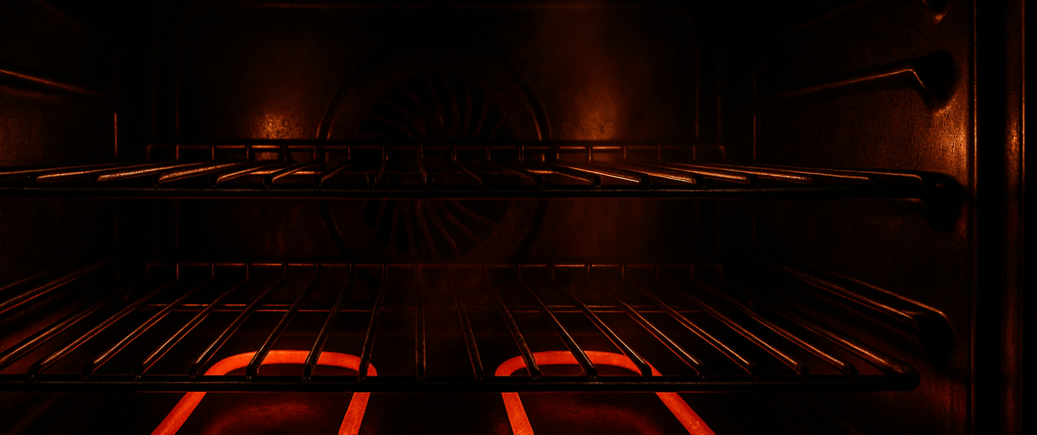

Self-cleaning ovens work in one of two ways: either by baking away grime at an extremely high heat (GE ovens will heat to 880° F, or 471° C, during self-cleaning) or by blasting your oven’s interior with steam to loosen and soften food debris. That said, “self-cleaning” isn’t an entirely accurate term. First of all, there will always be something to wipe up at the end of the cycle, be it ash or loosened grime. Second, many self-cleaning ovens recommend maintaining a regular manual cleaning schedule of about once per month, and even suggest pre-cleaning the oven before running the cycle. Still, high-heat self-cleaning ovens definitely cut down on the amount of elbow grease required to get rid of crud. Just make sure you know what

In a high-heat model, the self-cleaning cycle will bring the temperature in the oven to between 800 and 1,000 degrees Fahrenheit, depending on the oven model. For safety, the oven door automatically locks, and then, over the course of a few hours, any food left in the oven is incinerated. What’s left behind is ash that can be wiped away with a damp towel once the cycle is complete (and the oven has been allowed to cool).
High-heat cleaning is effective at getting rid of deeply caked on grime, reducing what might’ve taken you an hour of scrubbing to ash. It can take several hours to complete a cycle, though. The high heat also poses certain risks that you should account for before running a self-cleaning cycle. We’ll go over what you should watch out for and the steps you can take to avoid problems in the next section.

Running your oven at 1,000° F might give you pause, and for good reason. The components in home ovens aren’t designed to sustain that much heat, and there’s a pretty good chance that one or more parts in your oven will break if the cycle is run too long. Most likely to go are the thermal fuses, which are safety measures that control just how hot an oven is allowed to get before it is shut off. If these fuses are blown and the oven doesn’t stop working entirely, other parts like the control panel, thermostat, and door locking mechanism could also wind up damaged.
Repeated and excessive use of a high-heat cleaning cycle could render more durable parts like the heating element brittle and could cause them to break. In some rare cases, the glass front of your oven could crack or shatter.
