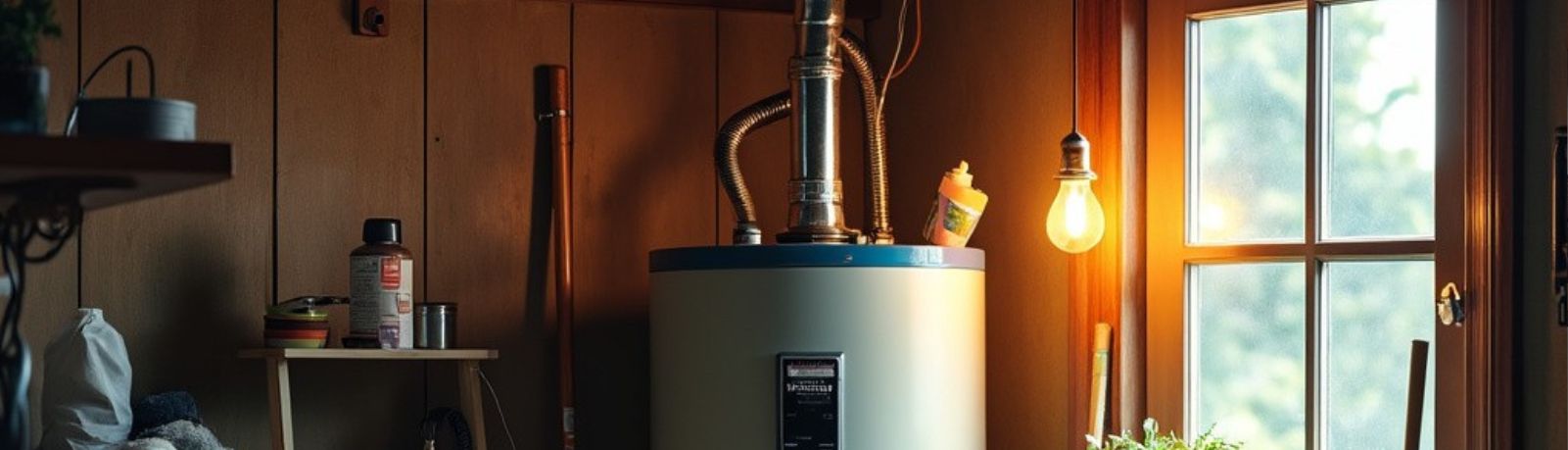

If your gas water heater’s pilot light won’t stay lit or the burner keeps going out, don’t order a replacement yet! It might just have a dirty thermocouple. This part makes sure the pilot light is on so gas can flow to the burner. When it gets dirty, it can cause a weak connection that prevents the water heater from working correctly.
Fortunately, you can quickly and easily clean the thermocouple yourself to avoid paying for costly repairs or replacements.
