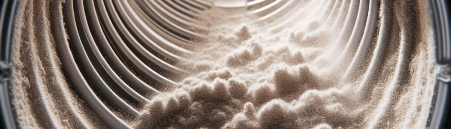

Dryer vent maintenance tips
If you allow lint to build up in your dryer, it can restrict airflow, which causes the dryer to work harder and use more energy. A clogged vent also poses a major fire risk since the trapped lint can heat up and ignite.
Here’s how you can cut down on the lint and keep your dryer safe to use:
- After every load, clean the lint filter to allow for proper airflow and prevent buildup that could start fires. Remove any lint or debris that’s accumulated in the filter. Rinse and scrub the filter with a mild detergent to remove stubborn debris; make sure it’s completely dry before reinstalling.
- Check the mesh screen of the filter for tears and replace it if it’s damaged.
- Regularly inspect and clean the venting system to ensure it’s free from blockages. Use a vacuum cleaner or a long-handled brush to remove any lint or debris that may have accumulated in the vent housing. Be sure to clean the entire length of the duct and the vent attached to the back of the dryer.
- Clean the drum regularly to remove any accumulated lint or debris. Use a soft brush or a clean cloth to wipe down the interior of the drum.
- Check the door seal (gasket) regularly and replace it if it’s not sealing properly.
- Check the vent hood on the outside of your home for debris and damage. Replace it with a new one if needed. Use a vacuum or cleaning kit with a long-handled brush to remove lint and other debris inside the ducting.
