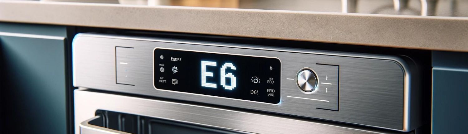

How to clear an E6 error on a Bosch dishwasher

What does the E6 error code mean?
The E6 error code usually indicates an issue with the dishwasher’s AquaSensor (also known as a turbidity sensor or clean water sensor). It monitors the cleanliness of the water during the wash cycle to determine how much soil has been removed from the dishes.
Based on the aqua feedback, the dishwasher control board will lengthen or shorten wash and rinse cycles accordingly. If the E6 error appears, it means the control board is unable to read a signal from the AquaSensor to gauge the water’s cleanliness.
There are several possible causes behind an E6 error code, including:
- A faulty AquaSensor
- Loose wiring connections
- Control board issues
- Clogged filters
