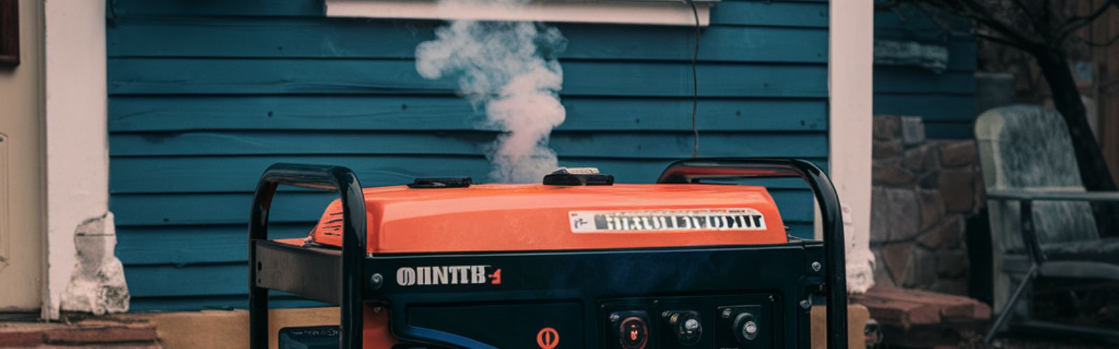

Excessive smoke from the exhaust
Excessive smoke can be caused by burning oil, poor-quality fuel, or a rich fuel mixture. Depending on the color of the smoke, it can indicate different problems: white smoke often suggests burning oil, while black smoke can indicate that the engine is running too rich with fuel. If you see white or blue smoke coming from the exhaust, or if your generator is running poorly, burning oil or using poor fuel could be the issue.
DIY fix:
- Start by checking the oil level and quality. If the oil is too high or contaminated, it could cause the engine to burn it. Change the oil if necessary, using the recommended type and amount for your generator.
- Inspect the fuel system. If the fuel is old or of poor quality, it might cause problems. Drain the fuel tank and replace it with fresh, clean fuel.
- Check the air filter to ensure it’s not clogged, as a dirty filter can cause a rich fuel mixture. Replace the air filter if it’s dirty or clogged.
- If the problem persists, you can use a multimeter to test the fuel pump and its electrical components. A malfunctioning fuel pump could be causing an improper fuel mixture, leading to excessive smoke.
