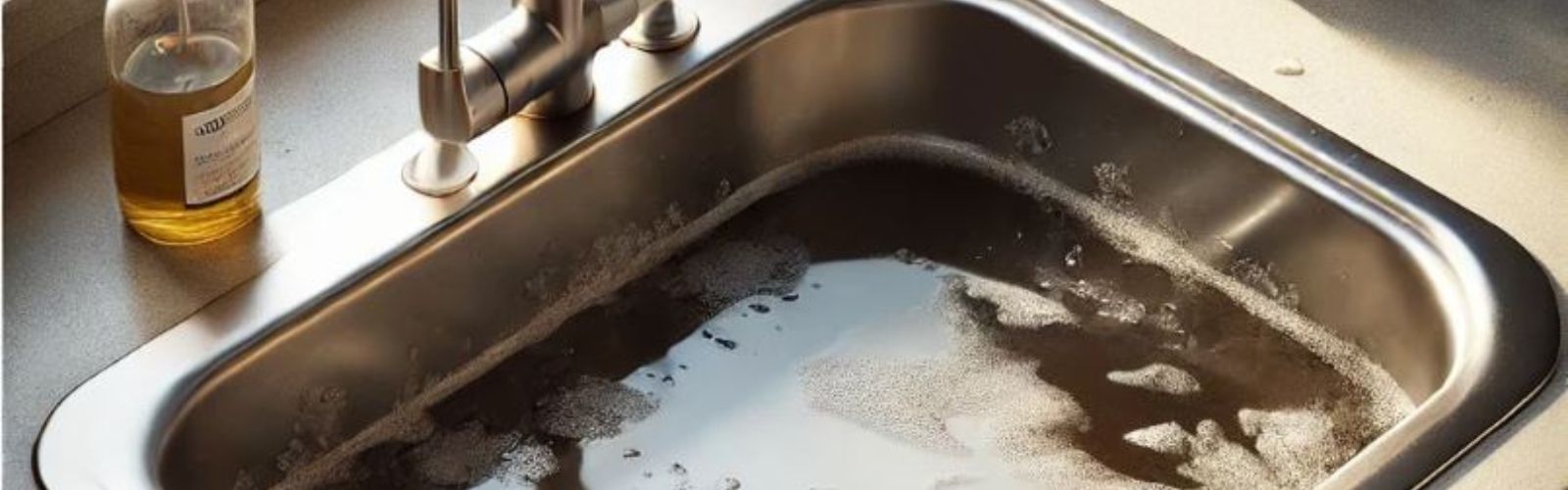

How to fix a garbage disposal that is draining slowly
Steven E / Monday March 17, 2025
A slow-draining garbage disposal can be a real headache, leaving your sink backed up and your kitchen routine in chaos. The good news? It’s usually something you can fix yourself without too much hassle. Whether it’s a simple clog, grease buildup, or something deeper in the pipes, we’ll help you figure out what’s going on and how to get your disposal back to draining like a pro!
