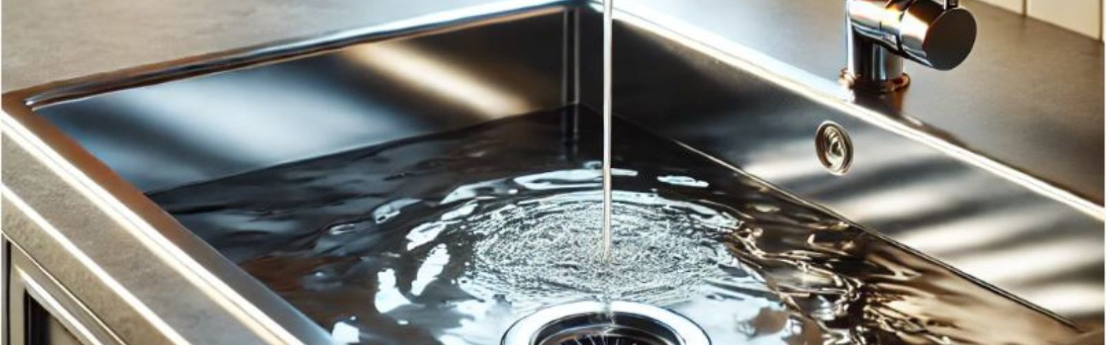

While a bit of water might not seem like a huge deal, standing water in your disposal isn’t something to brush off. Let’s check out why this happens and how you can tackle it yourself.

Why is there water sitting in my garbage disposal?
Normally, water should flow right through your garbage disposal and down the drain. If it starts to back up, it’s often a sign of a clog or some other underlying issue. Let’s look at some common reasons this might be happening.
1. Clogs in the disposal or drain line
A frequent cause is a clog inside the disposal unit or the nearby drain pipes. Food scraps, grease, and other debris can build up over time, causing blockages.
Signs of a clogged disposal
- Water drains slowly or does not drain.
- Bad smells coming from the sink.
- Unusual noises when you run the disposal.
