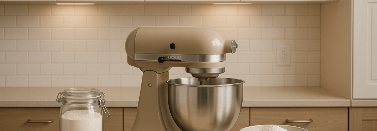

Your KitchenAid stand mixer is the workhorse of your kitchen, tackling everything from light batters to dense bread dough with ease. But if you notice a burning smell while it runs, it’s a signal that something isn’t right.
A burning smell doesn’t mean your mixer is beyond repair. Most of the time, it’s something simple you can check and fix yourself. This guide will walk you through what that burning smell means, how to safely diagnose the problem, and what you can do to repair it step by step.
The information in this article may not apply to your specific appliance model. We recommend consulting your manufacturer’s documentation or contact us with any questions.
Why Does Your Mixer Smell Like It’s Burning?
A burning smell from your stand mixer almost always comes from one of three things:
- Overheating motor or electrical parts.
- Worn gears grinding inside the gearbox.
- Old or degraded grease is breaking down and burning.
Each of these issues is fixable, and catching them early can prevent further damage. Below, we’ll cover how to tell which one you’re dealing with, and how to fix it.
