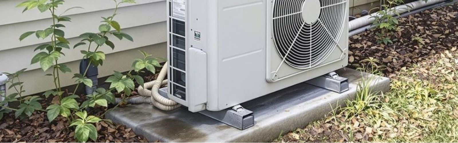

Set up the outdoor unit
- Find a stable spot: Place or mount the outdoor condenser on something solid with good airflow. Keep it clear of debris or tall grass. If you’re using a wall bracket, follow its instructions to anchor it securely.
- Check the clearance: The condenser needs space around it to work right. Most manufacturers specify how far it should be from walls or other obstacles.
- Connect the refrigerant lines to the condenser: If your system has pre-charged lines, you’ll usually attach them to the outdoor unit using the right connectors. Tighten them according to the recommended torque. Too loose, and you get leaks; too tight, and you might damage things.
- Finish the wiring: Hook up the electrical wiring from the indoor unit to the outdoor unit. Every mini split has a control cable or wires that let the two units talk to each other. Double-check that the wiring matches up with the color-coded terminals or labels in the manual.
- Test for leaks or vacuum (if needed): If your system isn’t pre-charged, you might need to vacuum the lines to get rid of air and moisture. This involves connecting a vacuum pump and gauge set to the service ports on the outdoor unit. Once you reach the required vacuum level, close the valves to hold it, then carefully open the refrigerant lines as directed by the manufacturer.
