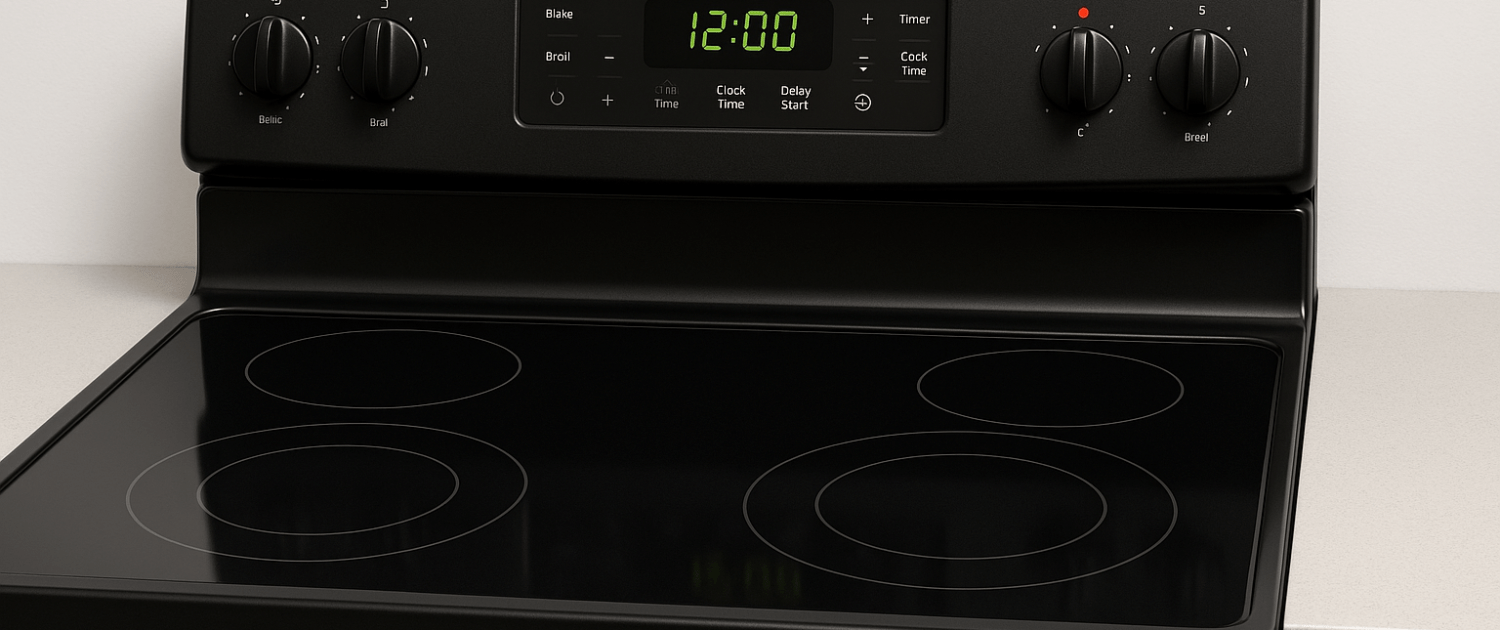

How To Fix a Samsung Range Hot Surface Light That Stays On
Steven E / Friday June 20, 2025
That hot surface light on your Samsung electric range won’t turn off—but why? Even when the cooktop is cool, the light stays on, likely due to a faulty burner switch. We’ll show you how to troubleshoot the issue and replace the part so your range works as it should.
