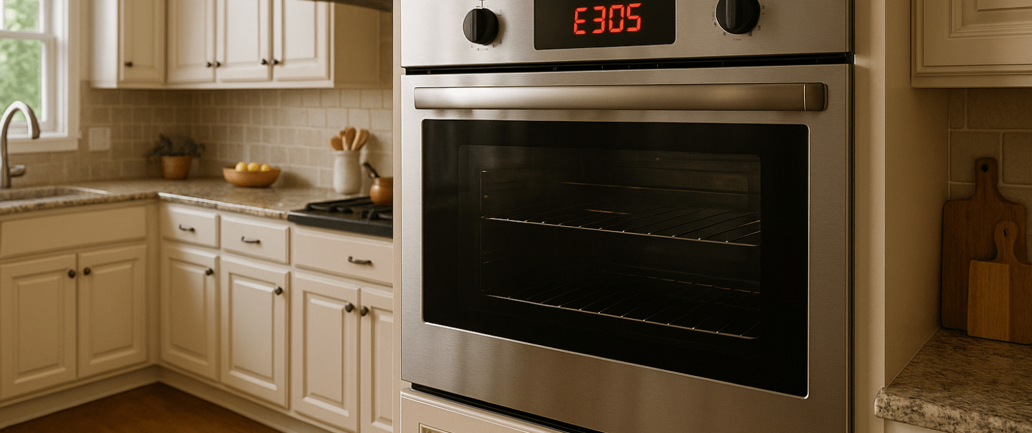

Is your Bosch oven flashing the E305 error code and not responding like it should? We’ll break down what the E305 error really means and walk you through how to troubleshoot and fix it yourself.

What does the error code mean?
On Bosch 800 series slide-in gas ranges, the E305 error message on the front control panel indicates a communication issue between two specific components:
- The touch control module (TCM) – This is the interface board behind the glass touchscreen. It monitors the touch pads and communicates with the control module.
- The control module – This is the main controller board that regulates oven functions. It communicates with the TCM and other range components.
Specifically, the E305 code means communication is lost between these two boards. It could also mean communication is lost between the TCM and the user interface display.
When this error occurs, the touchscreen and display will be unresponsive. The oven won’t heat up and no cooking functions will operate. A reset is required to restore functionality.
The problem stems from a wiring or component fault rather than a software issue. So the solution involves checking connections, wires and ultimately replacing a faulty main control board.
