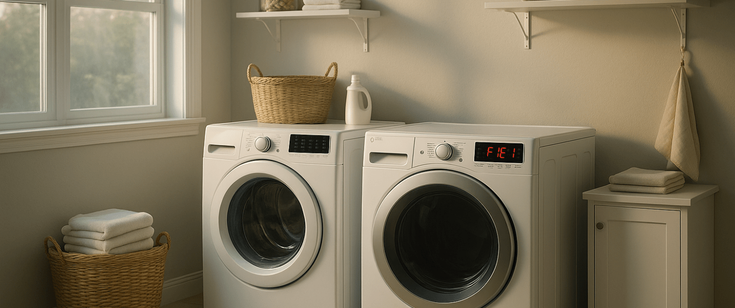

If you own a Whirlpool or Maytag front-load dryer, you may encounter an F1E1 error code at some point. This code can be frustrating, but with the right information, you can troubleshoot the issue and get your dryer running again. In this article, we’ll break down what the F1E1 Maytag dryer error code means, and its common causes, and provide a step-by-step guide to diagnosing and repairing the problem.

What does the error code mean?
The F1E1 error code appears on the user interface control when it indicates a problem with voltage to the heating system in Whirlpool and Maytag front-load dryers. Specifically, it means no voltage is detected at the heater relay. This relay controls power to the heating elements and is a key component in generating heat.
In electric models, the dryer uses heating elements to warm the air. On gas models, the relay activates the gas valve and ignition system. If the relay isn’t getting voltage, it can’t turn on the heat source.
Without proper voltage to the heating system, the dryer won’t be able to raise the air temperature needed to dry your clothes. The F1E1 code is designed to alert you to this electrical issue before running a cycle.
