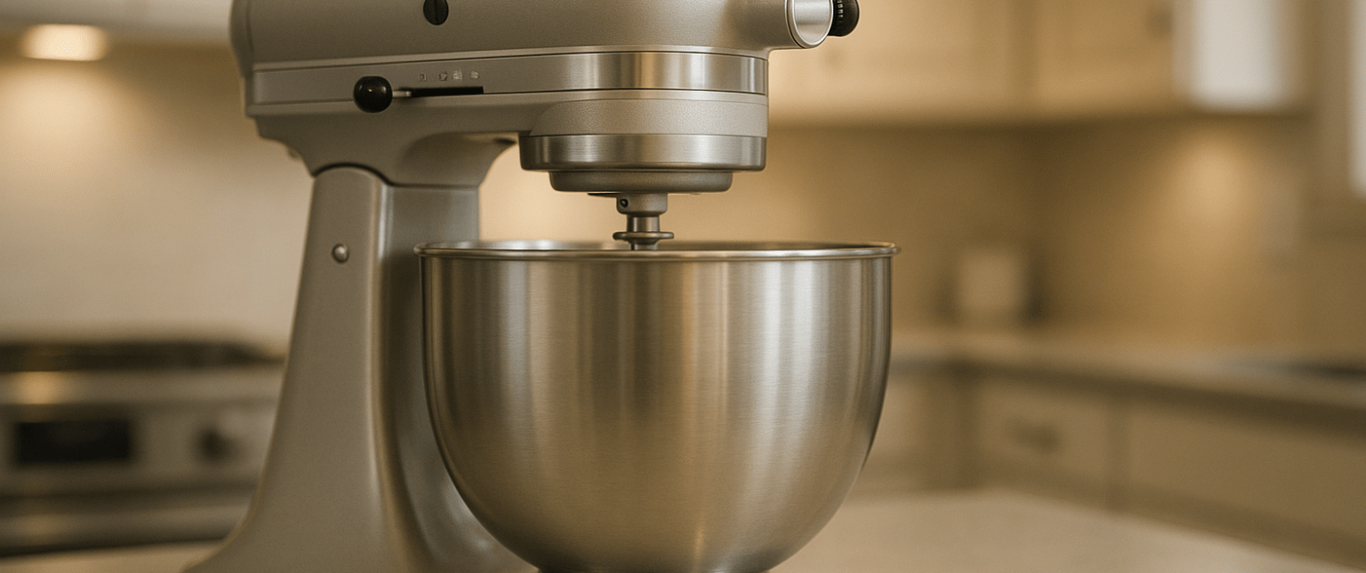

Your KitchenAid stand mixer is a workhorse in the kitchen, until something goes wrong. Whether it’s making weird noises, refusing to turn on, or not mixing properly, it can throw your baking plans into chaos. Don’t worry, though! This guide will help you diagnose the most common KitchenAid mixer problems so you can get back to whipping, kneading, and mixing like a pro.
