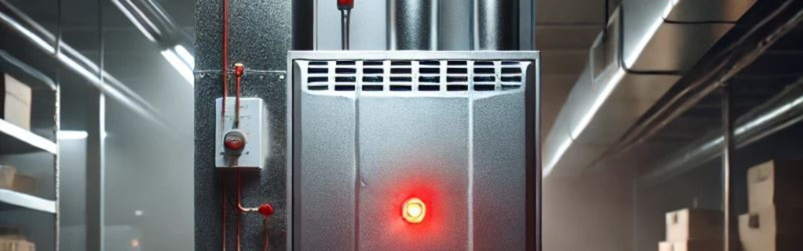

What those blinking lights mean
When your furnace starts flashing a light code, think of it as its way of sending an error signal. These codes are designed to help you pinpoint and troubleshoot specific issues. Each blinking pattern corresponds to a particular issue, and by decoding them, you can take the steps needed to sort things out.

Step 1: watch the blinking pattern
First, take a good look at the blinking pattern of the furnace light. Count how many times it flashes and note any pauses between them. This sequence is key to decoding the exact error your furnace is experiencing.
