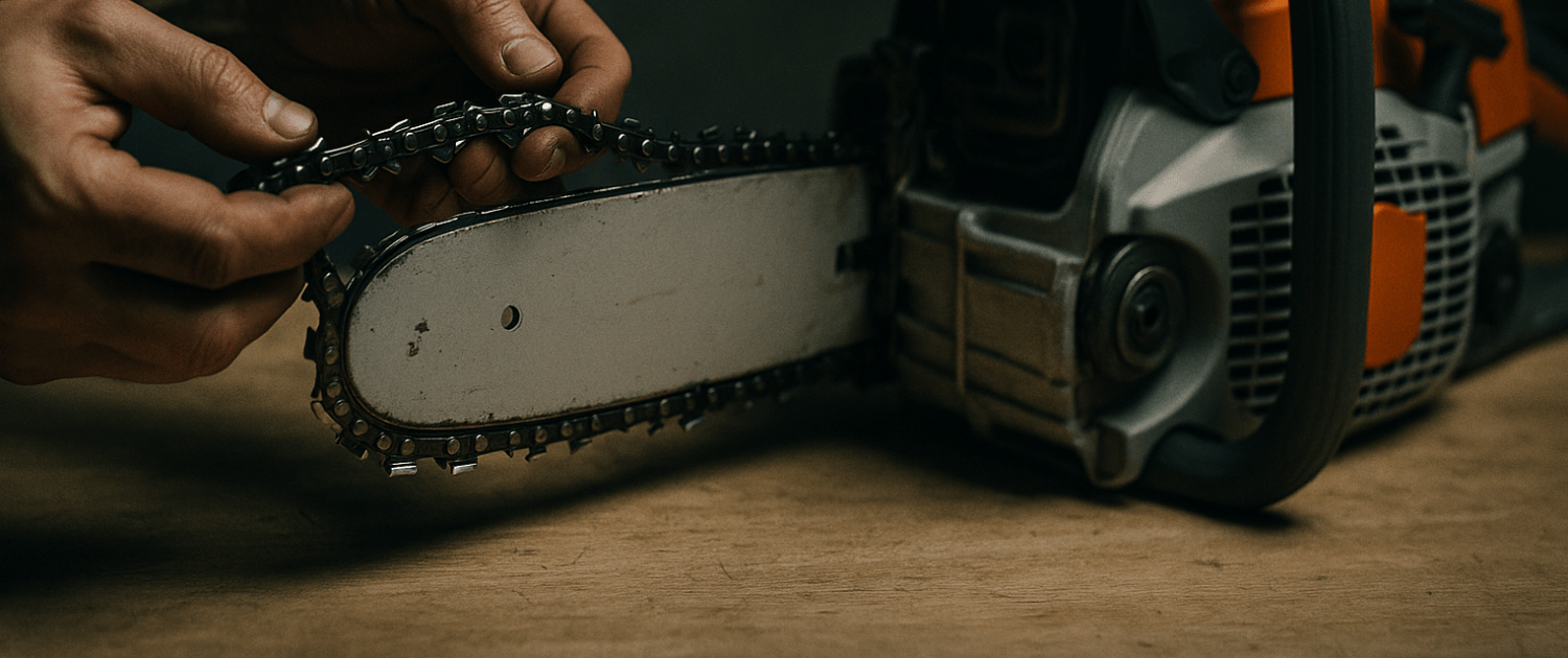

Replacing A Chainsaw Chain
- First of all, make sure the chainsaw is off and completely cool. Don’t do any work on your garden tools if they’re powered on. If your chainsaw was running recently, give it a few minutes to cool down before you start to avoid accidentally burning yourself.
- Disengage the chain brake. On some models, having the chain brake engaged when you do this will make the new chain much more difficult to install.
- Using a socket, remove the two bolts holding the bar onto the chainsaw body and remove the side plate. This will give you access to the chain.
- Loosen and remove the chain. You can accomplish this by pulling the chainsaw bar away from the body. This will free the chain from the tensioner, allowing you to easily slip it off.
- Inspect and clean up! Check the bar itself for any signs of damage – make sure it’s not cracked, dented, or bent. If it’s in good shape, it’s time to clean it up. Clean the groove out to remove any sawdust or other debris that might’ve built up, and then clean the oil holes out as well.
- Find the tensioning screw and loosen it. This flathead screw manages how tight the chain sits on the bar, so loosen it up before you put the new chain on to have an easier time with the install. You’ll likely find the tensioning screw near where the guide bar meets the body, though some chainsaw models place it between the two bolts that held the side panel on.
- Install the new chainsaw blade.
- Starting at the clutch drum, work the chain up the bar to the end of the chainsaw. The blade’s links should be pointing away from you – in the direction the saw turns.
- Make sure the drive links are properly engaged in the sprocket.
- Apply a bit of tension as you go to make sure everything is aligned properly. You can do this by gently pulling the bar away from the chainsaw body at the nose.
- Reinstall the side case and the bolts that hold it on, but don’t tighten the bolts down completely. Check that the chainsaw chain can move freely once you’ve threaded the bolts on.
- Tighten down the tensioning screw. The chain should have a little give on the guide bar so that it can move freely, but not be slack. You shouldn’t be able to pull the links out of the bar nose.
- Tighten the bolts down completely. Once you’ve got the right tension on your chain, you can finish tightening the other bolts back on.
- Double check the chain brake. The chain should not be able to move when the brake is engaged.
