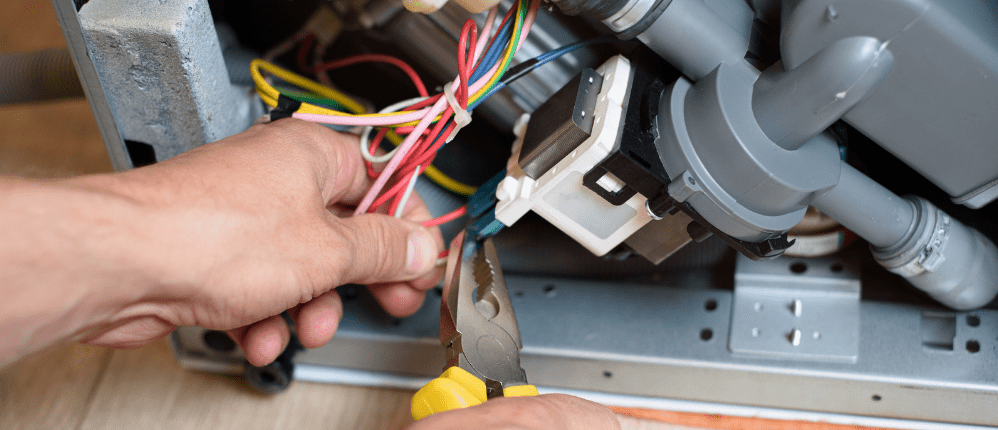

Accessing the Circulation Pump Motor
Now that you have everything you need, it’s time to access the circulation pump motor in your dishwasher. The specific method for accessing the pump motor can vary depending on your dishwasher’s make and model. Follow these general steps to reach the circulation pump motor:
  1. Open the Dishwasher Door: Fully open the dishwasher door to gain access to the interior.
  2. Remove Lower Dish Rack: Pull out the lower dish rack to create more workspace inside the dishwasher.
  3. Locate the Circulation Pump: The circulation pump is typically located at the bottom of the dishwasher’s interior. It may be covered by a panel or shield.
  4. Remove the Front or Bottom Panel: Depending on your dishwasher model, you might need to remove the front or bottom panel to access the circulation pump. Look for screws or clips holding the panel in place. Use a screwdriver to remove the screws or gently release the clips to detach the panel.
  5. Identify the Circulation Pump Motor: Once you have removed the panel, locate the circulation pump motor. It is connected to the dishwasher’s main pump and is responsible for moving water throughout the appliance during the wash cycle.
*Please note that the steps for accessing the circulation pump motor may vary slightly depending on your dishwasher’s specific design.
With the circulation pump motor now visible, you’re ready to move on to the next section and begin testing the electrical components with a multimeter. This step is crucial to determine if the motor is indeed faulty before proceeding with the replacement process.

Removing the Old Circulation Pump Motor
Now that you’ve confirmed that the circulation pump motor is faulty, it’s time to replace it with a new one. Follow these steps to remove the old circulation pump motor from your dishwasher:
  1. Locate and Disconnect Electrical Connections: Identify the electrical connections to the circulation pump motor. These are typically plug-style connections or wire terminals secured by screws. Use your pliers or screwdriver to carefully disconnect the wires from the motor.
  2. Remove Mounting Brackets or Clips: Check for any mounting brackets or clips securing the circulation pump motor to the dishwasher’s base or housing. Use the appropriate tool to release them and free the motor.
  3. Detach the Motor: Gently lift and remove the old circulation pump motor from its position. Be mindful of any gaskets or seals that might be attached to the motor.
  4. Inspect the Old Motor: Take a moment to inspect the old motor for any signs of damage, wear, or debris. This information can be helpful for diagnosing potential issues and ensuring the new motor’s installation goes smoothly.
Before installing the new motor, consider taking pictures or making notes of the wiring connections and other relevant details. This documentation will help guide you during the installation of the replacement motor.
