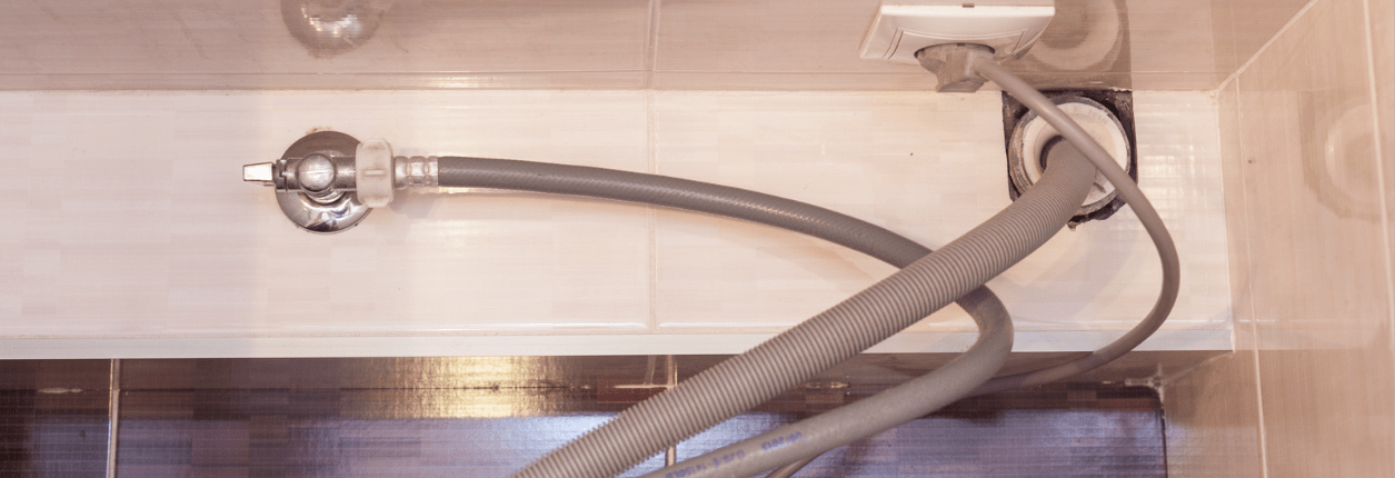

Step-by-Step Guide for Replacing the Dishwasher Drain Hose
Follow these step-by-step instructions to replace the dishwasher drain hose and restore proper drainage:
- Turn off the power supply to the dishwasher by switching off the circuit breaker or unplugging it. Also, shut off the water supply to the dishwasher to prevent any leaks.
- Depending on your dishwasher model, you may need to remove the bottom front panel or the kick plate to access the internal components.
- Refer to the dishwasher’s user manual or online resources specific to your model for instructions on how to access the drain hose.
- Locate the drain hose at the back of the dishwasher where it connects to the drain pump.
- Using pliers or adjustable wrenches, carefully loosen and disconnect the hose clamp securing the drain hose.
- Gently pull the old drain hose away from the drain pump and the sink drain or garbage disposal.
- Take the new drain hose and connect it to the drain pump first, ensuring a secure fit.
- Next, connect the other end of the drain hose to the sink drain or garbage disposal.
- Use hose clamps to secure the connections, ensuring they are tight but not overly tightened to avoid damage.
- Reassemble the dishwasher by putting back the bottom front panel or kick plate.
- Turn on the water supply and the power to the dishwasher.
- Run a short test cycle to check for any leaks or issues with the newly installed drain hose.
By following these steps, you can successfully replace the dishwasher drain hose and restore proper drainage. It’s important to refer to the dishwasher’s user manual or seek online resources specific to your model for any additional instructions or considerations.
