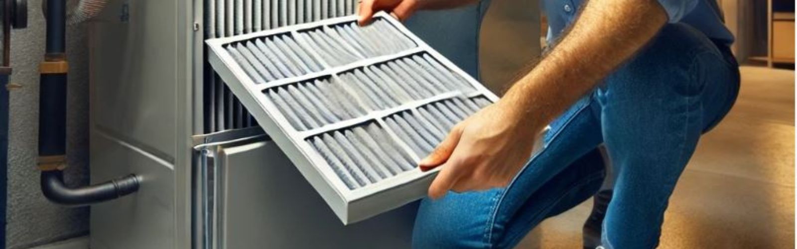

Ready to change that filter? Here’s how to do it:
- Turn off the HVAC system. For safety and to keep debris from blowing into the system while you work, shut off your furnace. You can flip it off at the thermostat or hit the main power switch. This step protects both you and your HVAC gear.
- Figure out the right filter size. Before grabbing a new filter, you need to know the size your system takes. Using the right dimensions is crucial; the wrong size can cause issues or even harm your system. You can usually find the size on the old filter’s frame or in your furnace’s manual. Not sure? Here’s how to find your appliance’s model number for more help.
- Find the filter slot. The filter’s usually located where the return air duct meets the furnace or inside the blower compartment. If you’re having trouble spotting it, check your furnace’s manual. Knowing where it is makes the swap smoother.
- Remove the old filter. Carefully slide out the old filter. Go slow to avoid shaking loose dust and debris into the system or your home. Pop the used filter into a plastic bag to trap the dust, and toss it properly.
- Pop in the new filter. Grab your new filter and look for the airflow arrows on the frame. These arrows should point toward the furnace, showing the direction the air flows. Slide the filter into the slot, making sure it fits snug without any gaps. Placing it right is key for it to work well.
- Turn the HVAC system back on. With the new filter in place, turn your furnace back on. Your system’s now set to run more efficiently with better air quality. It’s a good idea to check that the furnace is running smoothly after you’re done.
