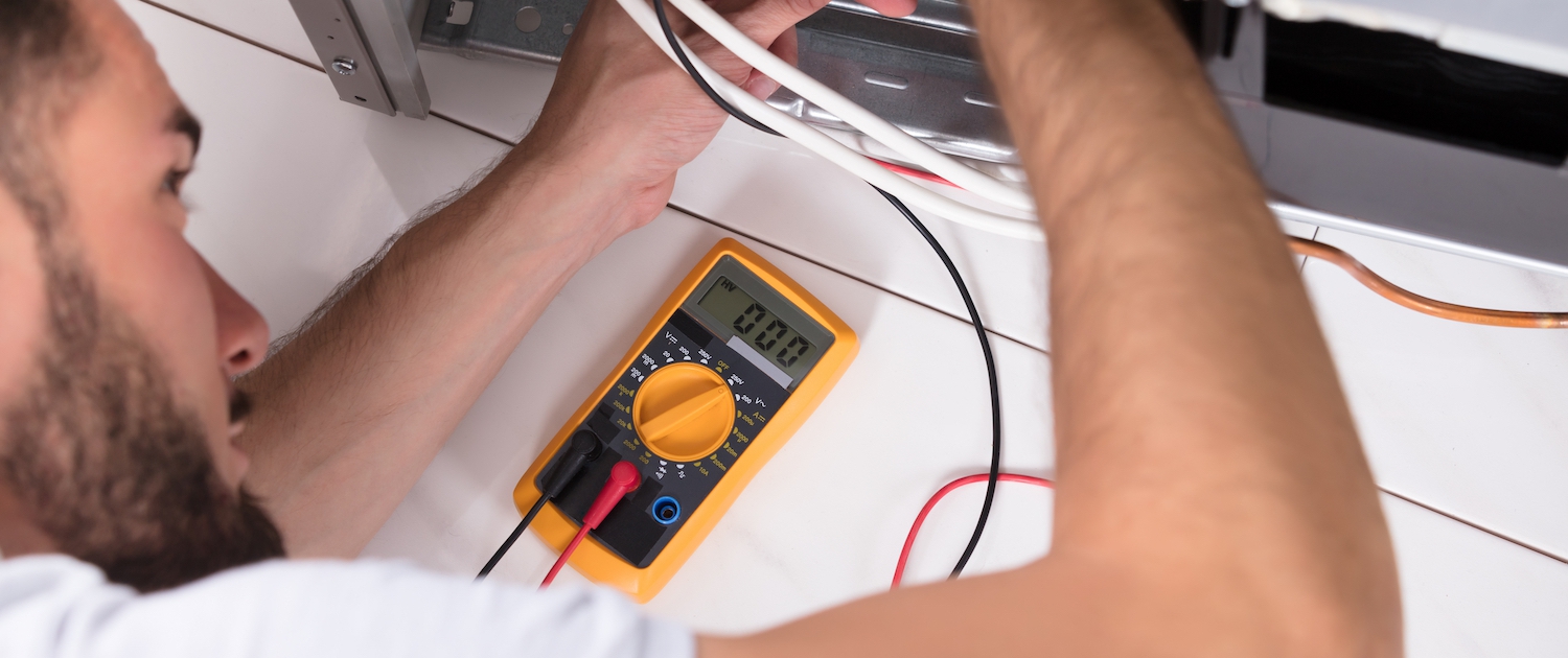

- The relay has no connectivity. If you have a multimeter, you can test the relay for connectivity. Once again, follow steps one through seven to remove your fridge’s compressor start relay for testing. If it has none, it has failed, and needs to be replaced.
