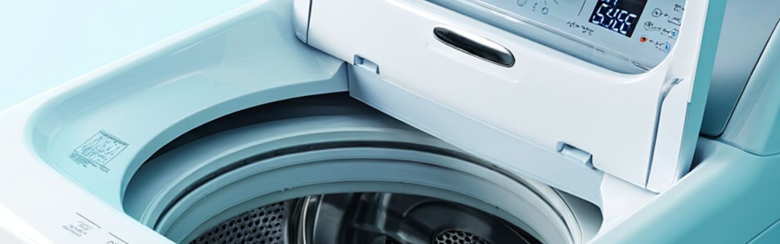

How to Resolve Frigidaire Washer Error Code E55 Quickly
Steven E / Tuesday April 1, 2025
If your Frigidaire washer displays the E55 error, this is a fairly common problem that can often be resolved with some straightforward troubleshooting steps. We’ll walk you through the most likely causes and how to fix the issue yourself without the need to call in a repair technician.
If you find out that you need any replacement parts for your appliance while you’re troubleshooting, you can enter your model number at AppliancePartsPros.com to order them. Most orders arrive in just two business days, and we have thousands of free guides to show you how to install your new parts.
What does the error code mean?
The E55 error code indicates the washer’s motor has overheated. When the washer’s control system detects that the motor is overheating, it triggers the E55 error code and responds by shutting down the wash cycle to prevent further overheating and potential motor burnout.
