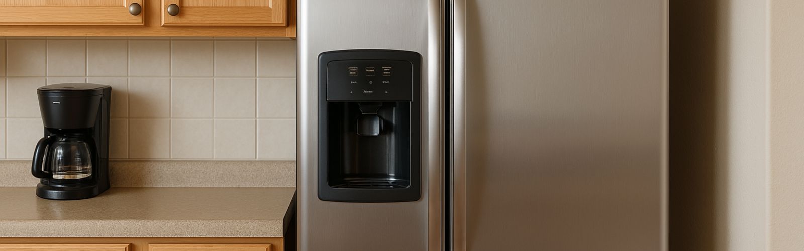

Is your Frigidaire refrigerator refusing to dispense ice, leaving you in a frosty situation? The culprit might be a faulty freezer door wiring harness, but don’t worry—you can troubleshoot and fix it yourself with ease. Just below, you’ll find a step-by-step video guide to help you resolve this chilling dilemma and get your appliance back in action!

If your Frigidaire refrigerator isn’t dispensing ice, the problem may be with the freezer door wiring harness. This part is responsible for sending signals from the freezer door switches to the ice maker and dispenser controls.
