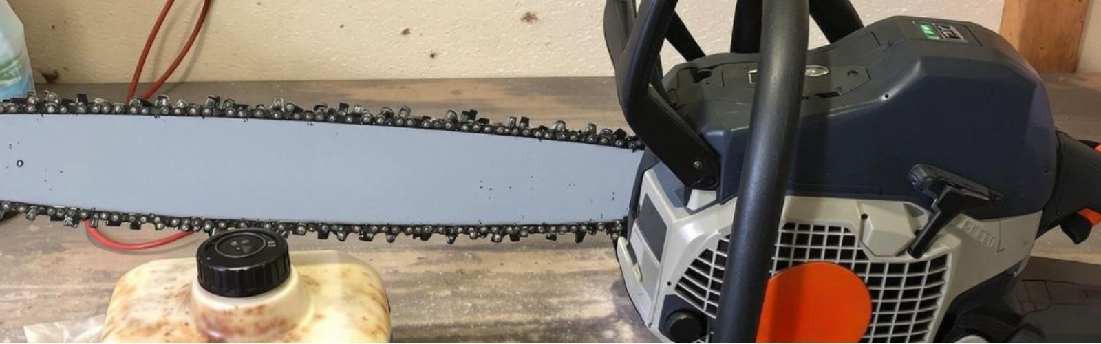

How to test a chainsaw oil pump
Testing your oil pump can help you figure out if it needs replacing or if the issue is somewhere else, like a clogged port or a damaged oil line. Gather up some basic tools: usually, a small flathead screwdriver or hex driver, pliers, safety gloves, and eye protection will do the trick.
- Check the oil level: Make sure the oil tank is filled up with the right bar and chain oil. If it’s running low, your saw won’t get proper lubrication.
- Clean the oil outlets: Wipe down the oil outlet ports on the chainsaw body and the bar to get rid of any sawdust or debris blocking the oil flow.
- Test the oil flow: With the saw off, put a piece of cardboard or paper on the ground. Fire up the chainsaw and hold it over the surface at medium speed. If you see oil splattering on the surface, that’s a good sign oil’s coming through properly.
- Check the oil filter and line: If oil isn’t making it to the chain, take a look at the oil filter inside the tank for clogs and make sure the oil line isn’t damaged or blocked.
- Adjust the oil pump (if you’ve got one): If your saw has an adjustable oil pump, double-check that the adjustment screw is set right for proper oil flow. Your manual will have the specifics.
- Remove the bar and chain: If the problem’s still there, turn off the saw and disconnect the spark plug wire or battery if needed. Take off the side cover, remove the chain, and slide off the bar to get direct access to the oil outlet.
- Check oil flow from the outlet: With the bar and chain off, start the engine briefly at low speed. Watch if oil comes out of the oil outlet. Wear your safety gear and only run it for a moment. If no oil shows up, it’s time to look at the oil pump itself.
- Inspect the oil pump and drive gear: Look for any physical damage to the oil pump or drive gear. A busted gear or stripped threads can stop the pump from working right.
How to replace a chainsaw oil pump
- Get the chainsaw ready: Disconnect or remove the spark plug wire. You don’t want the saw starting up while you’re working. Empty the oil tank by pouring any leftover bar and chain oil into a safe container.
- Take off the chain and bar: Remove the side cover. Lift the chain off the sprocket and slide the bar away from the saw. Give the bar a good clean to get rid of wood chips and old oil gunk.
- Access the oil pump: Depending on your chainsaw model, you might need to remove some extra covers or unscrew a few bolts holding the oil pump. Some saws have a gear-driven pump right under the clutch assembly.
- Remove the clutch (if needed): Certain models require you to take off the clutch drum to reach the oil pump. If that’s the case, follow your manual’s instructions for removing the clutch. You might need a special clutch removal tool, or you might have to secure the piston to loosen the clutch nut. Remember, threads can be reversed on some chainsaws, so pay attention.
- Take out the old pump: Carefully remove any screws or clips holding the pump in place. Slide the old pump away from the engine housing, noting how the drive gear or worm gear is positioned. Check any small plastic or metal drive parts for wear or damage.
- Install the new pump: Put the new oil pump in the housing just like the old one was. Make sure the drive gear meshes correctly. Sometimes the gear or worm is separate, so check the alignment so the pump turns freely.
- Put everything back together: Secure the pump with the right screws. If you removed the clutch drum, reinstall it, and put back any covers. Double-check that everything lines up and moves smoothly.
- Refill and test: Fill up the oil tank with fresh bar and chain oil. Reconnect the spark plug wire, then start the chainsaw for a quick test. Look for steady oil flow to the bar. Don’t rev the engine too high until you’re sure it’s lubing properly.
