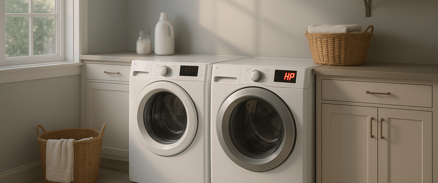

How to Troubleshoot the Maytag Dryer HP Error Code
Steven E / Friday May 9, 2025
Getting an “HP” error code on your Maytag Neptune dryer system can be frustrating, but this guide will walk you through how to diagnose and fix the issue. With a few simple troubleshooting steps, you can have your dryer back up and running smoothly, and the HP Maytag dryer error code resolved.

The HP error code stands for “high limit thermistor.” It indicates that the dryer’s thermistor is detecting temperatures outside of the normal operating range. This error code appears on both electric dryers and gas dryer models.
The thermistor is a heat sensor that monitors the temperature of the exhaust air. It sends input back to the control board. If the control board receives readings from the thermistor that are abnormally high or low, it will halt operation and display the HP diagnostic codes. These are clear signs of a thermistor malfunction.
