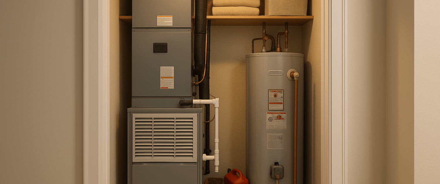

How to Replace Your Central AC Filter
This is one of the easiest and most valuable DIY tasks you can do as a homeowner. You don’t need any tools, and it only takes a few minutes.
- Turn off the AC unit at the thermostat for safety.
- Locate the filter. It’s usually found in the return air vent or inside the air handler/furnace.
- Remove the old filter and note its size. Most filters have the dimensions printed on the frame.
- Insert the new filter with the arrows pointing in the direction of airflow (typically toward the blower motor).
- Close the cover and turn the system back on.
