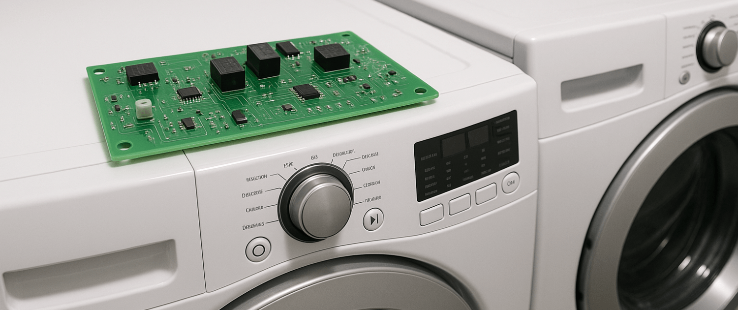

Unexpected error codes? A washer that won’t start or behaves erratically? When your LG front-load washer starts acting up, the main PCB (printed circuit board) might be to blame. This component controls everything from wash cycles to draining, and when it fails, your machine won’t function properly. Whether you have a gas or electric model, we’ll show you how to test and replace the main PCB to bring your washer back to life.
