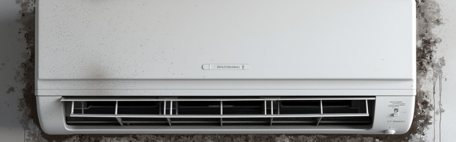

Understanding mold growth in mini split systems
Mold, it’s that pesky fungus that thrives in dark, damp spots. When your mini split’s evaporator coils and filters collect moisture, it creates the perfect breeding ground for mold. Sure, your AC is supposed to handle humidity and keep things comfy, but if the air is too humid or the unit stays wet for too long, mold can set up shop. You might catch a whiff of that telltale musty smell, see dark patches on filters, or even notice mold growing on internal parts.
Those mold spores don’t just stay put, they spread through the air, which can lead to health problems and mess with your indoor air quality. A moldy mini split might end up circulating those spores around your whole house. Since we all want to keep our homes clean and the air we breathe healthy, it’s important to tackle mold by going after its main culprits: excess moisture and organic gunk that mold feeds on.
